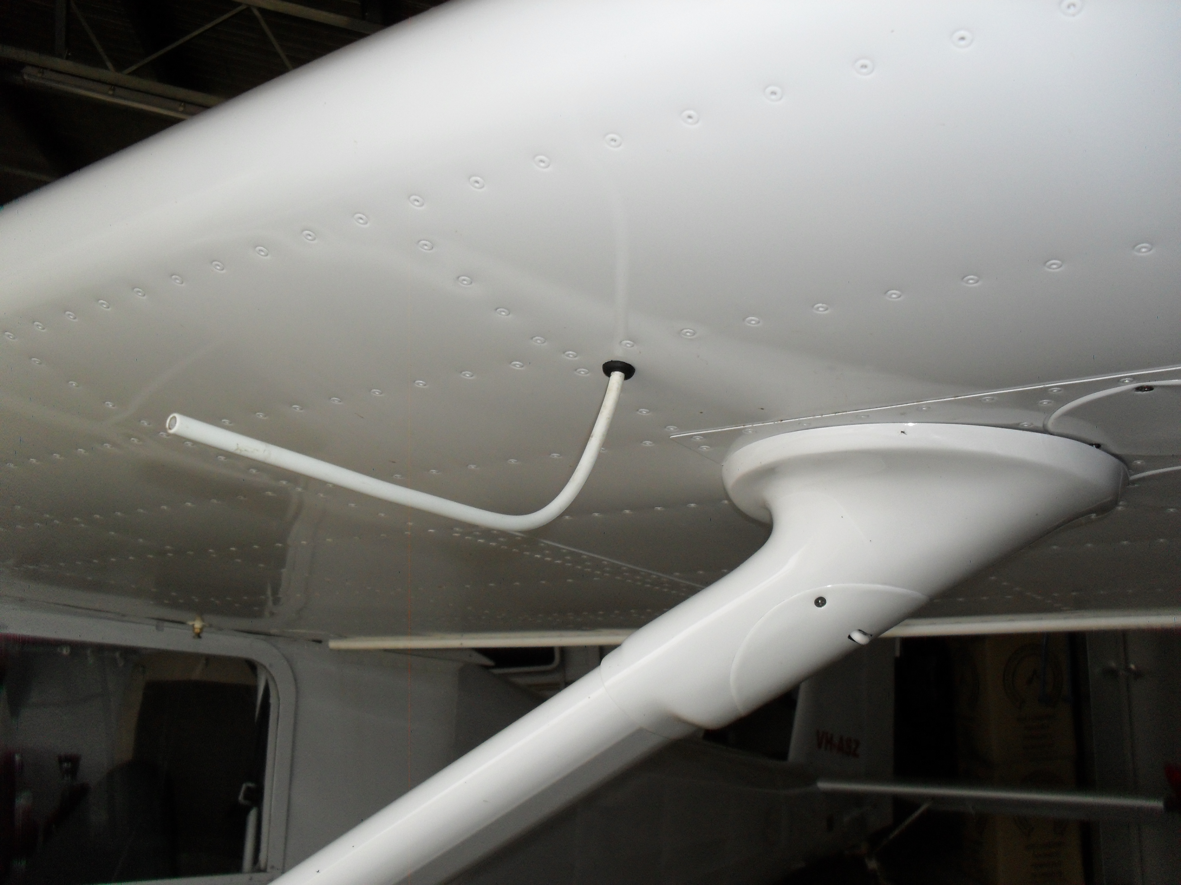

Mine is similar except on aft side of the main spar and inboard of the strut.
Works fine and big bonus is that unlike the trailing edge and the strut, I've never hit my head or poked my eye on the pitot!
1/4" tubing is fine as there is no flow in the tubing.

Here is another approach. Made from quarter inch versatube, suitably shaped and secured with cable ties inside the wing. Some of the plumbing is one eighth tubing. Simple, cheap, light, and works perfectly. In this case the plumbing passes through the wing D section and into the cabin through the fuselage root rib.
