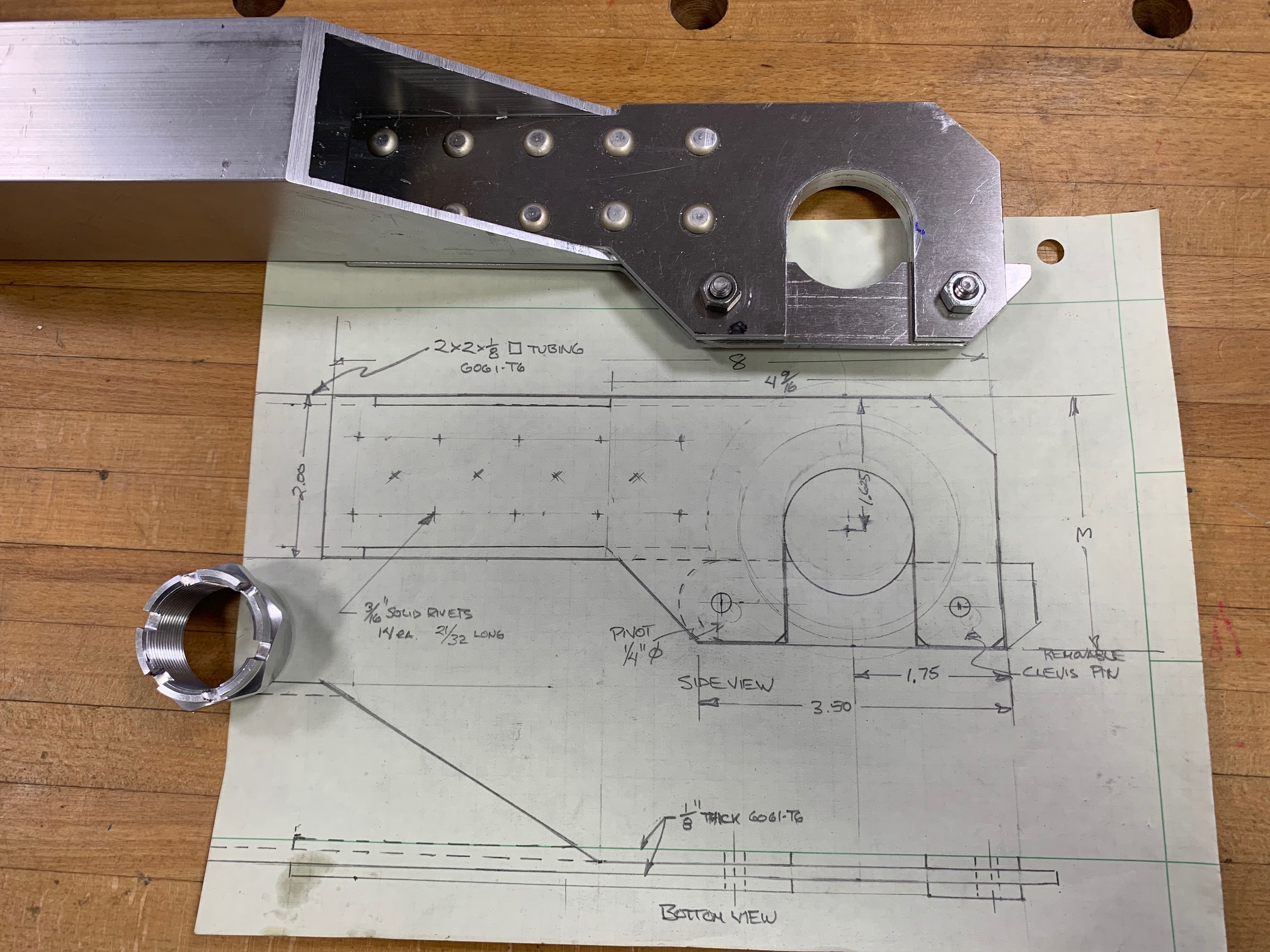

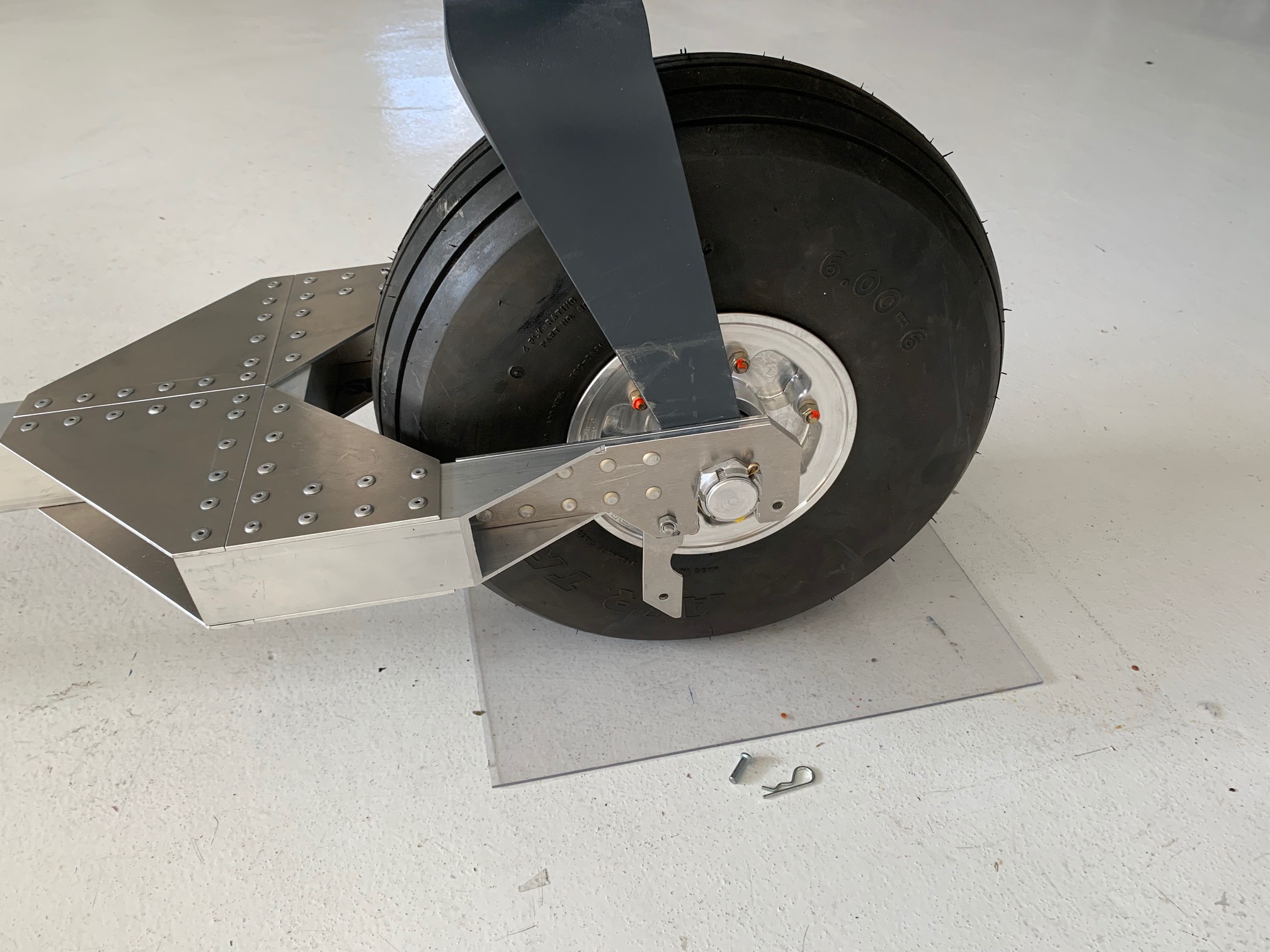

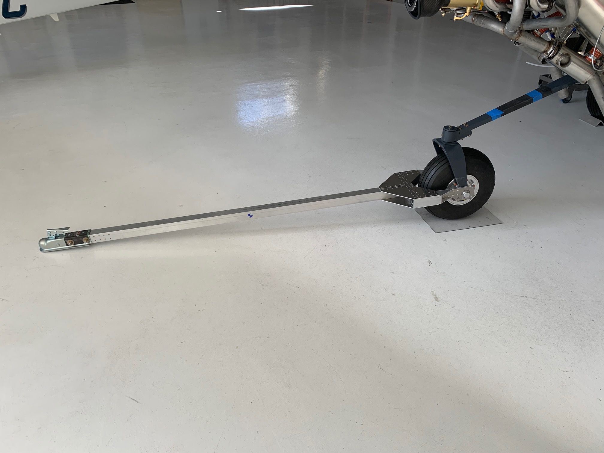

Didn't see a good fit for standard tow bar designs for the Nose Gear axle on my Yukon so I made custom design to hook over O.D. of axle nut.
Main square tube is 2x2x.125 wall 6061-T6 with 2" ball Receiver.

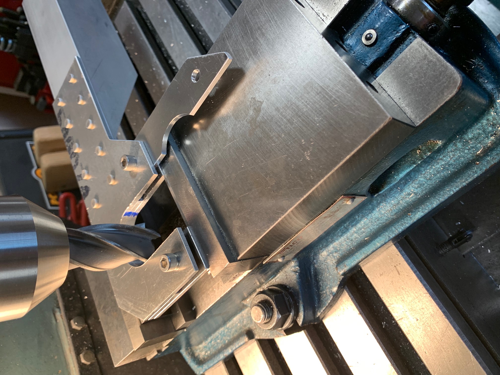

The Tow Hook is riveted of 2 layers of 1/8" flat stock plus one wall of the square tubing. The center layer is slightly narrow to allow a slot for a pivoting bottom clip for locking on.

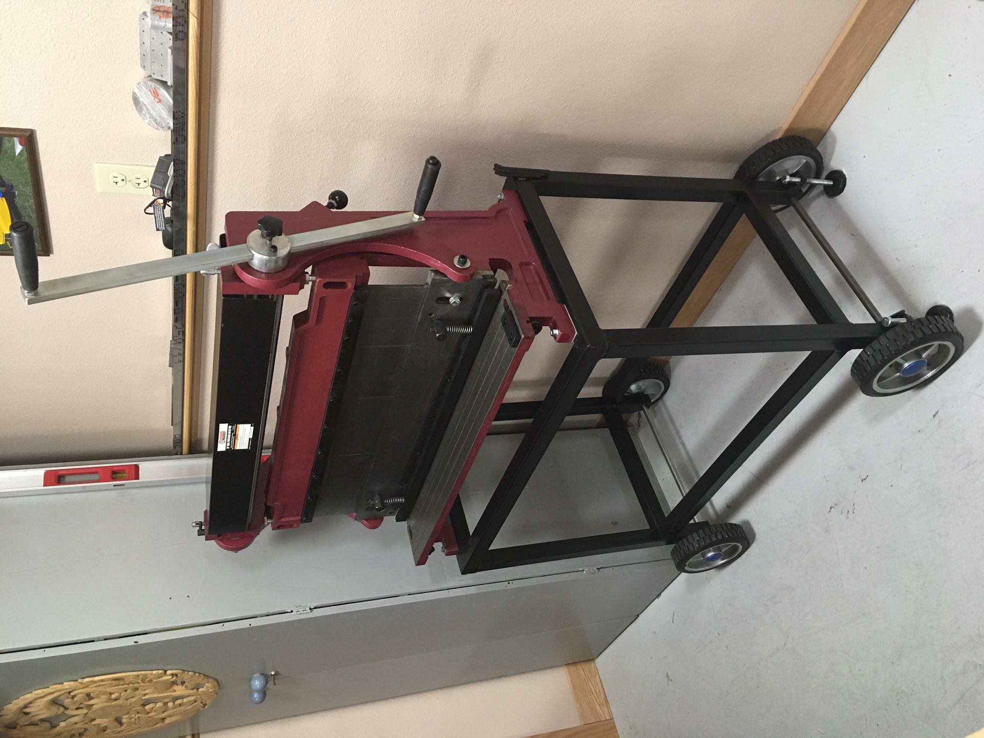

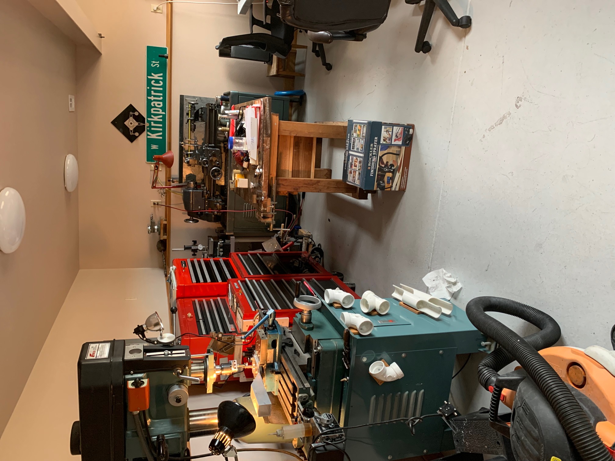

Yeah, some builders are proud they built an airplane only with hand tools and not even a drill press. I must be lazy or more demanding of precision. I am glad I have Lathe, Mill , Gas and TIG Welders. I am a rare Mechanical Engineer that likes to learn trade skills. After College instead of buying furniture , I bought a Table Saw, Drill Press and Router. Later Jointers and Planers. When finished with furniture and many house upgrades I moved on to metalworking with a small 6" metal lather, later moved up to 10" Logan with thread cutting and Gear change capability, built a bunch of tools for lathe and mill and also a RF controlled Robot. The airplane has given me an excuse to add sheetmetal tools such as the Shear/Brake. Nice to have the tools and capability when the factory parts don't fit like the Nose Gear pivot being 0.005" larger than the bushing ID or the option to build a cable tension gage instead of the high priced ones.
