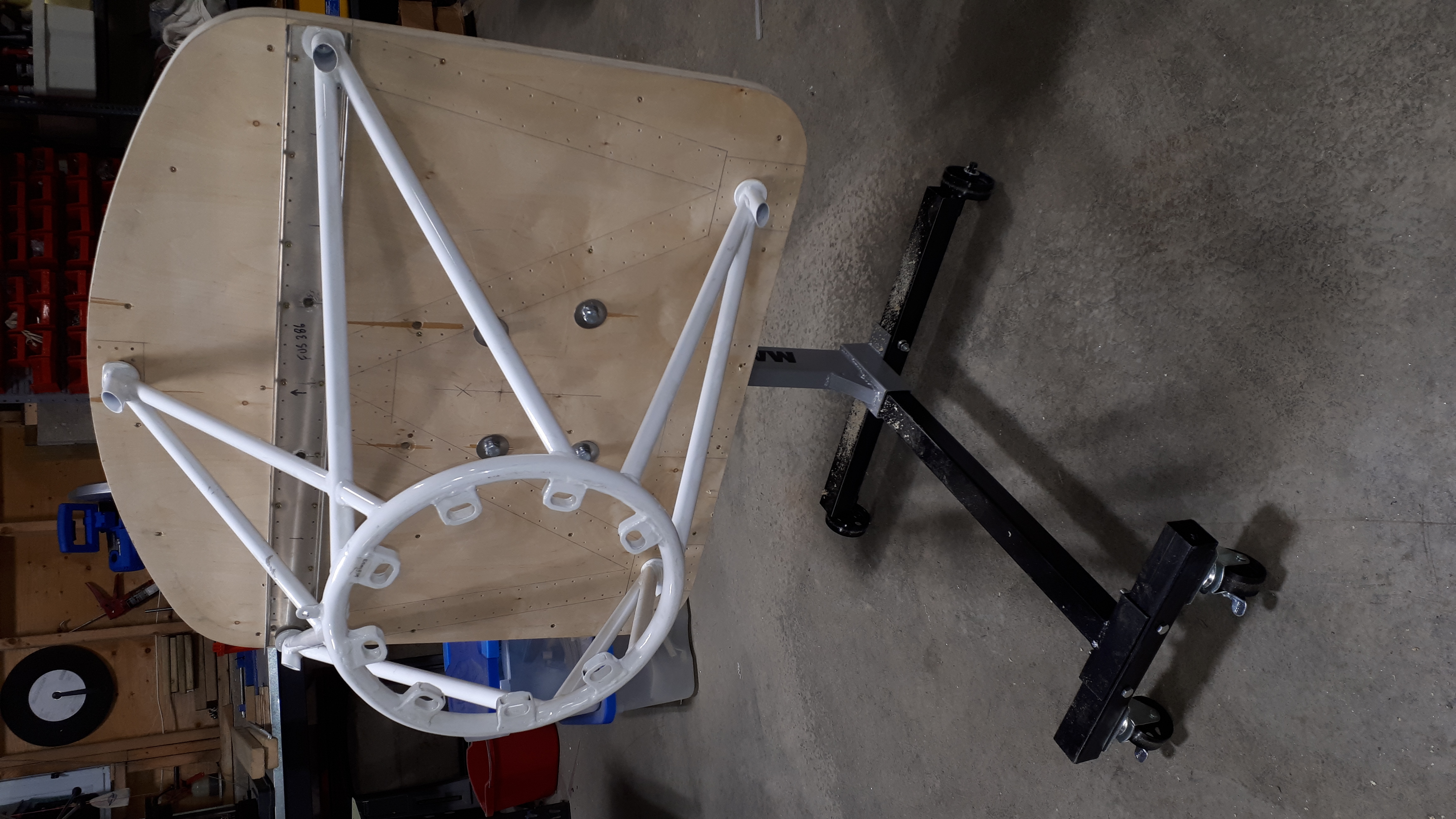

Spent yesterday mocking up firewall so I can build cowl.
I need to modify stand so it has a bigger footprint and is more stable.
