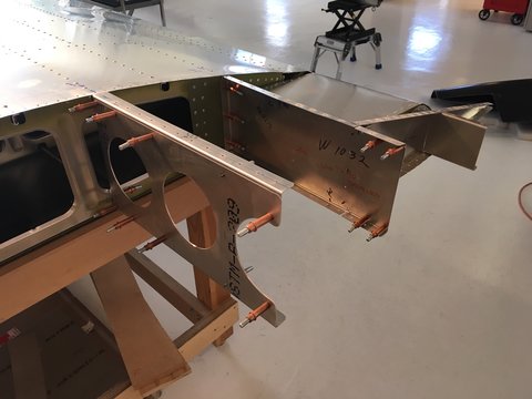

I modified and added Spar extensions to help stiffen the Fiberglas Droop tip on my Yukon, The aft end of the wingtip was quite floppy with just the spade box support as mentioned in my Moose manual.
1) First of all I was not furnished any Spar Extensions for the Wing Tips so bent my own up with 0.032" and drilled 5" dia. lightening holes.
2) The Spar extension at front of the Spade had a doubler provided in the kit which was longer than the spade box so I added flanges to the part that extended past the provided spar extension. This added support 4" farther out at the spade corner.
3) Last modification was bending up a short spar extension 4.5" long that would attach the the spade box rib. The aft end of the wing tip is now quite stiff and also lined up with aileron except the tip was 5/8" longer than the aileron.
Droop Tip inner structure

Paul, Sorry for late reply, I don't have email notification setup with the forum so didn't see your questions.
I cut tip with 0.040" abrasive cutoff disc in 4.5" did angle grinder. Yes I did set up the tip with aileron in the 5 deg reflex. I put the tips on when the wing was my assembly table. I put 3 stringers inside fiberglass top and another 3 each bottom not counting the spar extensions. They stop just 1/16" short of the wing skin. The spar extensions are attached with 3/4" rt angle x 1/8 thick that riveted to wing stringers inside of wing and then extend out though the last rib like the manual explained. A key point is to have tail of wingtip restrained to match aileron reflex when drilling tip to wing. This is important to have it aligned when it is done.
I also installed LED wingtip lights I used Wheel Microburst II series ( same as Microburst III but not certified) If you want planeFAA certified for night flight you will need the Microburst III lights. Installed a 0.032" doubler inside the fiberglas with anchor nuts for the light. Made the doubler 1" wider and longer than the light footprint.
As far as Gas Tank test, I used 50 inches of water as pressure and used a scheider valve ( inner tube stem valve ) so you can add in short bursts and avoid risk of blowing up tank. I wondered same thing about temp install of the gas tank access panels but was advised that the temp install and then the final install also created risks. I went ahead and prosealled the access panels and riveted. On left tank had one leak that was from center of an access panel tank rivet ( must have failed the end seal on rivet). Easy to proseal from outside.
Right tank had a slow leak through the tank rib inside the curl of the stringer on top skin. Cut access panel outside tank in bottom and repaired from there.
