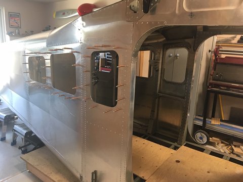

Just passing along technique I used on my Yukon to cut Window openings with little requirement for trimming.
The Window frames have a tooling hole that is at the center of radius for 2 opposing corners.

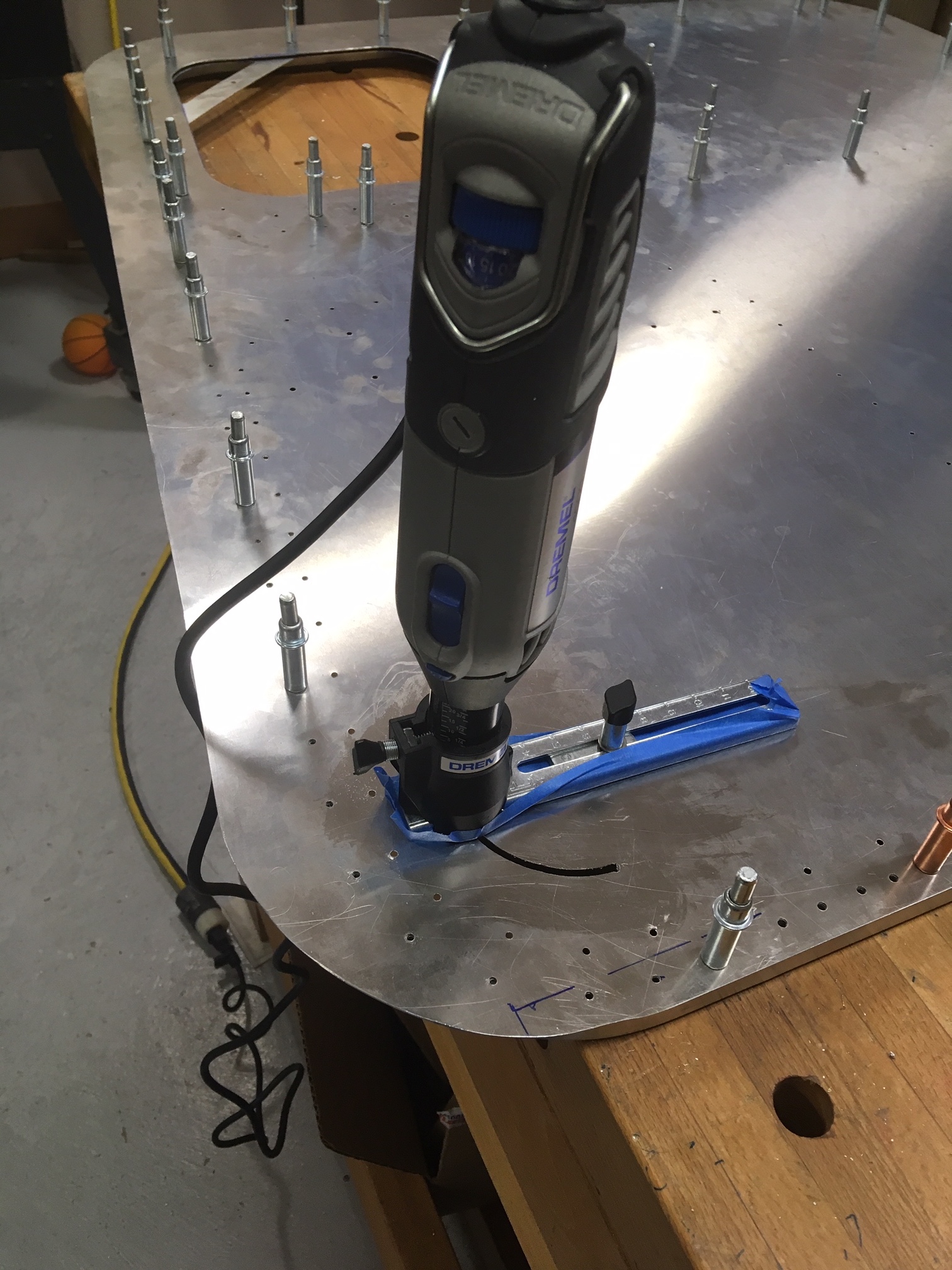

7) Use Dremel with Circle Cutting Guide and a RotoZip 1/8" bit. The pivot point on Circle cutter is 1/8" Set Pivot Point to radius and lock down. ( the pivot slide is a bit sloppy in the track so I used 0.032" shim to jam it tight so it would not move or twist. )
8) Use lubricate ( AlumTap or equivalent) the bit to avoid galling the bit which will cause ragged edges and uneven slot width.
9) Tape bottom of Cutting guide to avoid scratches and Cut arcs in clockwise directions.
10) Tape edge of straight lines and cut with hand nibbler.
11) File and sand edges and debur.
